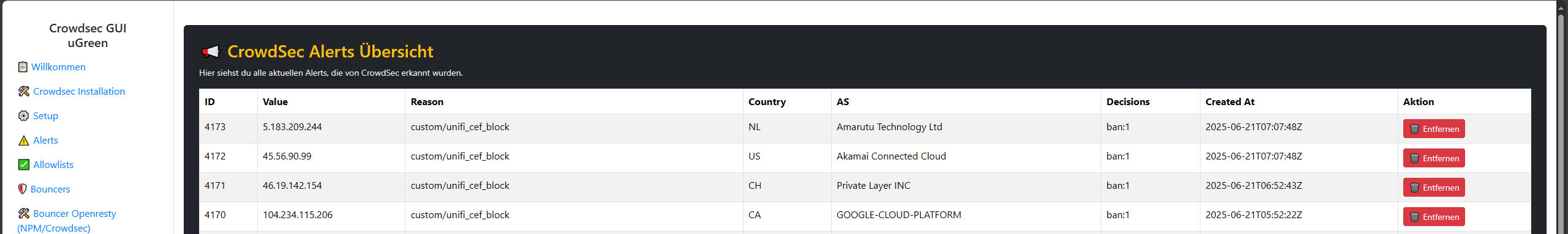

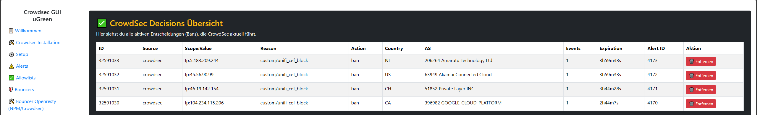

Praxisbeispiel:
Siehe Bilder und hier ist die Zeile aus dem Syslog auf was Reagiert wurde:
2025-06-21T07:52:22.108+00:00 CEST 192.168.1.2 CEF:1|Ubiquiti|UniFi Network|9.0.114|security_detections-68564896e9146d405e7afbd3|IPS Alert 2: Misc Attack. Signature ET DROP Dshield Block Listed Source group 1. From: 104.234.115.206:21328, to: 192.168.1.242:80, protocol: TCP|Medium|signature_type=ET signature_id=2402000
und diese:
2025-06-21T09:07:47.867+00:00 CEST 192.168.1.2 CEF:1|Ubiquiti|UniFi Network|9.0.114|security_detections-68565a43e9146d405e7b0261|IPS Alert 1: A Network Trojan was detected. Signature ET MALWARE Generic Dropper Installing PUP 1. From: 192.168.1.20:57012, to: 45.56.90.99:80, protocol: TCP|High|signature_type=ET signature_id=2021101

Praxisbeispiel:
2026-02-18T07:30:30+00:00 unifi CEF: 0|Ubiquiti|UniFi Network|9.5.21|201|Threat Detected and Blocked|7|proto=TCP src=65.49.1.152 spt=31392 dst=192.168.10.242 dpt=80 UNIFIcategory=Security UNIFIsubCategory=Intrusion Prevention UNIFIhost=unifi UNIFIsite=default UNIFIdeviceMac=9c:05:d6:6d:d1:f1 UNIFIdeviceName=Gateway Max UNIFIdeviceModel=Gateway Max UNIFIdeviceIp=192.168.10.1 UNIFIdeviceVersion=4.3.1 UNIFIrisk=medium UNIFIipsSessionId=11874975625556 UNIFIipsSignature=ET DROP Dshield Block Listed Source group 1 UNIFIipsSignatureId=2402000 UNIFIutcTime=2026-02-18T06:30:30.835Z msg=A network intrusion attempt from 65.49.1.152 to 02:42:c0:a8:0a:f2 has been detected and blocked.
und diese:
2026-02-18T07:30:30+00:00 unifi CEF: 0|Ubiquiti|UniFi Network|9.5.21|201|Threat Detected and Blocked|9|proto=TCP src=192.168.10.20 spt=27923 dst=45.56.90.99 dpt=80 UNIFIcategory=Security UNIFIsubCategory=Intrusion Prevention UNIFIhost=unifi UNIFIsite=default UNIFIdeviceMac=9c:05:d6:6d:d1:f1 UNIFIdeviceName=Gateway Max UNIFIdeviceModel=Gateway Max UNIFIdeviceIp=192.168.10.1 UNIFIdeviceVersion=4.3.1 UNIFIrisk=high UNIFIipsSessionId=790026415351837 UNIFIipsSignature=ET MALWARE Generic Dropper Installing PUP 1 UNIFIipsSignatureId=2021101 UNIFIutcTime=2026-02-18T06:30:30.843Z msg=A network intrusion attempt from i9x64 to 45.56.90.99 has been detected and blocked.
